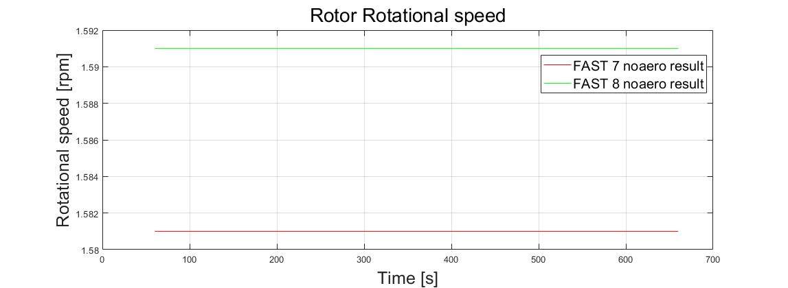

Blade moments are almost the same, But some results are weird.
I checked the input file one more time, there are no differences between FASTv7 and FASTv8 input.
I was confused why “RotSpeed” is different. Is it a reasonable result?

It looks like the rotor speeds are slightly different. Was RotSpeed initialized to the same value in both FAST v7 and FAST v8? Do you have any control enabled? What happens over the initial 70 s?

Yes, RotSpeed initialized to the same value.
I also simulated NREL 5MW RWT.
The simulation results are almost the same except RotSpeed. (like DTU 10MW simulation result)
FAST7 “RotSpeed” = 0.8599
FAST8 “RotSpeed” = 0.8642
To confirm If the ROSCO controller make this difference, I used Discon.dll what you provided(not used ROSCO controller)
The results are the exactly same. (“RotSpeed” also)
I think that some differences due to the ROSCO controller.
To be honest, I don’t know what makes a difference…
Please could you give me an opinion about these results?

Dear Seonghwan,
The ROSCO controller and the original controller for the NREL 5-MW baseline turbine are different, so, I would not expect the same response when switching controllers. If you are simply trying to compare differences between FAST versions, I would use the same controller in both versions.
That said, with aerodynamics disabled, I would disable the controller, which would not function properly without aerodynamic loads.
Dear Jason,
I’m sorry I seem to have confused you a little.
I used the original controller for both versions.
By the way, I solved the problem!
When the initial value of the rotor speed was set slightly lower than the rated speed, the same result came out.
