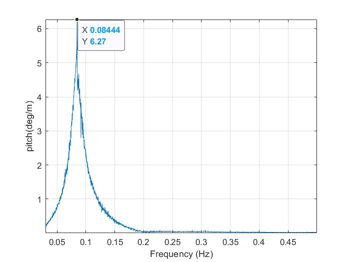

I was trying to compute the RAOs of ITI Barge using whitenoise wave spectrum without wind, then I found that the pitch RAO got unusually large in its peak frequency(as shown in figure1). However, after I add steady wind of 8m/s to the same wave condition, the pitch RAO becomes about 10% of the value without wind(figure 2), and this value seems normal, was it because the increase of aerodynamic damping reduces the peak of pitch RAO?
Does the simulation results seem right to you? I also attached the HydroDyn input file below.

Dear @Chen.Gu,
Yes, the results make sense to me.
