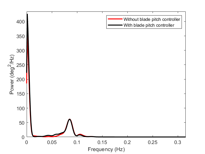

Dear @Jason.Jonkman,
I was trying to see the effect of the blade pitch controller on platform pitch dynamic response of the 5 MW barge-type FOWT in the case of short-crested waves.
Therefore, i run two simulations: the first is with blade pitch controller while the second is without.
I was quite surprised since i have not expected that the blade pitch controller has no effect on the response in contrast with the long-crested.
What do yo think ?
Did i do something wrong ?
The figure in the following shows the comparison of the PSDs of platform pitch with and without blade pitch controller:
Best Regards,
Riad
I’m sorry, but I’m not sure.
