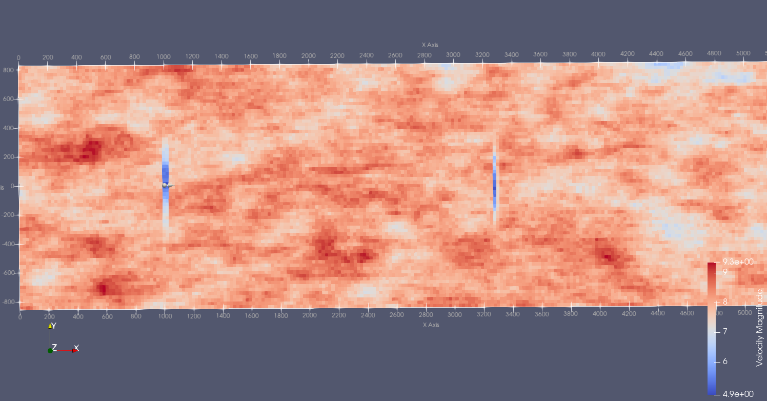

I’m running a simulation in FAST.Farm with an upstream turbine (T1) located 1000 meters away from the domain. However, I notice that at t=1, the wake is already visible across the domain in the first VTK file, even though physically, the wake should take about 125 seconds to propagate 1000 meters at a mean wind speed of 8 m/s.
From what I understand, FAST.Farm often uses a quasi-steady approach where the wake is calculated as an established (steady-state) field at each time step, rather than simulating its real-time propagation from t=0. This means the wake is effectively “projected” instantaneously across the domain, as if the turbine had been operating for a long time.
Is this behavior expected when using the quasi-steady wake model in FAST.Farm? Does the model intentionally initialize the wake field in this way, or could this indicate a misconfiguration?
attached is an image of the velocity field on the oxy plane for t=6 seconds

I’ve found the source of my confusion—I was using Mod_Wake = 2 (curl-based model), which doesn’t provide access to the grid nodes in the way I expected.

Dear @Tom.Salic,
I agree that when Mod_Wake = 2 (curled wake), FAST.Farm cannot output wake deficits at radial nodes; this limitation exists because the curled wake model is solved in rectangular coordinates rather than polar coordinates. Switching to Mod_Wake = 1 (polar wake) will solve this issue. If you want to see the wake deficit at each wake plane for any Mod_Wake setting, set OutAllPlanes = TRUE.
Regarding your other comment: FAST.Farm is initialized at time zero with 2 wake planes and adds a wake plane each low-resolution time step up until NumPlanes is reached. So the wake will continue propagating downstream until simulation time = DT_Low * ( NumPlanes - 2 ). FAST.Farm does not initialize with an established steady-state wake.
