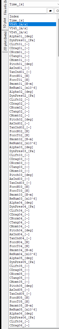

I get a filename <RootName>.AD.out, and when I visualize the results, I see that almost everything is included for each blade node (i = 1 to 45), except the velocity components; where only the latest (i.e., i = 45) component is present (in this case, only VX45, VY45, and VZ45 are there).
Is there a way to output VX, VY, VZ for all blade nodes for i = 1 to 45?

The PRINT option in the old AeroDyn v14 generated am element output file that only contained the velocity components of the most outboard element. I’m not sure why this decision was made, but it was certainly limited in that way. You’ll have to change the source code and recompile if you want other outputs generated, or upgrade to AeroDyn v15 within OpenFAST.
