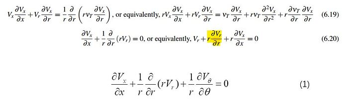

Dear @Jason.Jonkman ,
We know that the governing equations of the dynamic wake model are (6.19) and (6.20), while the continuity equation in the cylindrical coordinate system is (1). Therefore, the dynamic wake model assumes that the third term of equation (1) is 0. This will cause the results in Y and Z directions to be much smaller than the experimental results. Is there any relevant correction formula to make up for the speed loss in this regard?
Hi @YuMing_Yuan,
The third term of equation (1) is zero in FAST.Farm as you said (i.e. no derivatives in azimuthal direction), and it calculates the wake parameters as azimuthally averaged quantities. In other words, the wake is symmetric around the wake centerline (that is perpendicular to the wake plane). Note that wake planes are not parallel to the Y-Z plane when there’s the turbine tilt or yaw but they are always parallel to the rotor disk (assuming rotor yaw angle has not changed since the wake plane is created).
I guess the only way to compare experimental results to FAST.Farm is to average the measurement data also in azimuthal direction within the wake plane (and of course average everything in time to remove the turbulent fluctuations). This is how I understand it but let’s see how Jason would like to comment
Dear @YuMing_Yuan, and @Salur.Basbug,
I agree with @Salur.Basbug’s comments. The third term of (1) is zero for an axisymmetric solution, which FAST.Farm’s polar wake model assumes. There is no loss in accuracy to drop this term if the wake is in fact axisymmetric. If the wake is not axisymmetric, e.g. in the case of inflow skewed relative to the rotor axis, then some inaccuracies are expected.
Please note that we are introducing another wake modeling option in FAST.Farm that does not make use of axisymmetric assumptions–that is, we are introducing the curled wake model applicable to skewed flow conditions. This model is implemented in Cartesian rather than polar coordinates. You can find the curled wake pull request here: Implementation of the curled-wake model in FAST.Farm by ebranlard · Pull Request #931 · OpenFAST/openfast · GitHub, which will be merged once a couple improvements are made and the associated Wind Energy journal publication summarizing the development, implementation, and initial verification/validation of the curled wake model has been accepted for publication.
