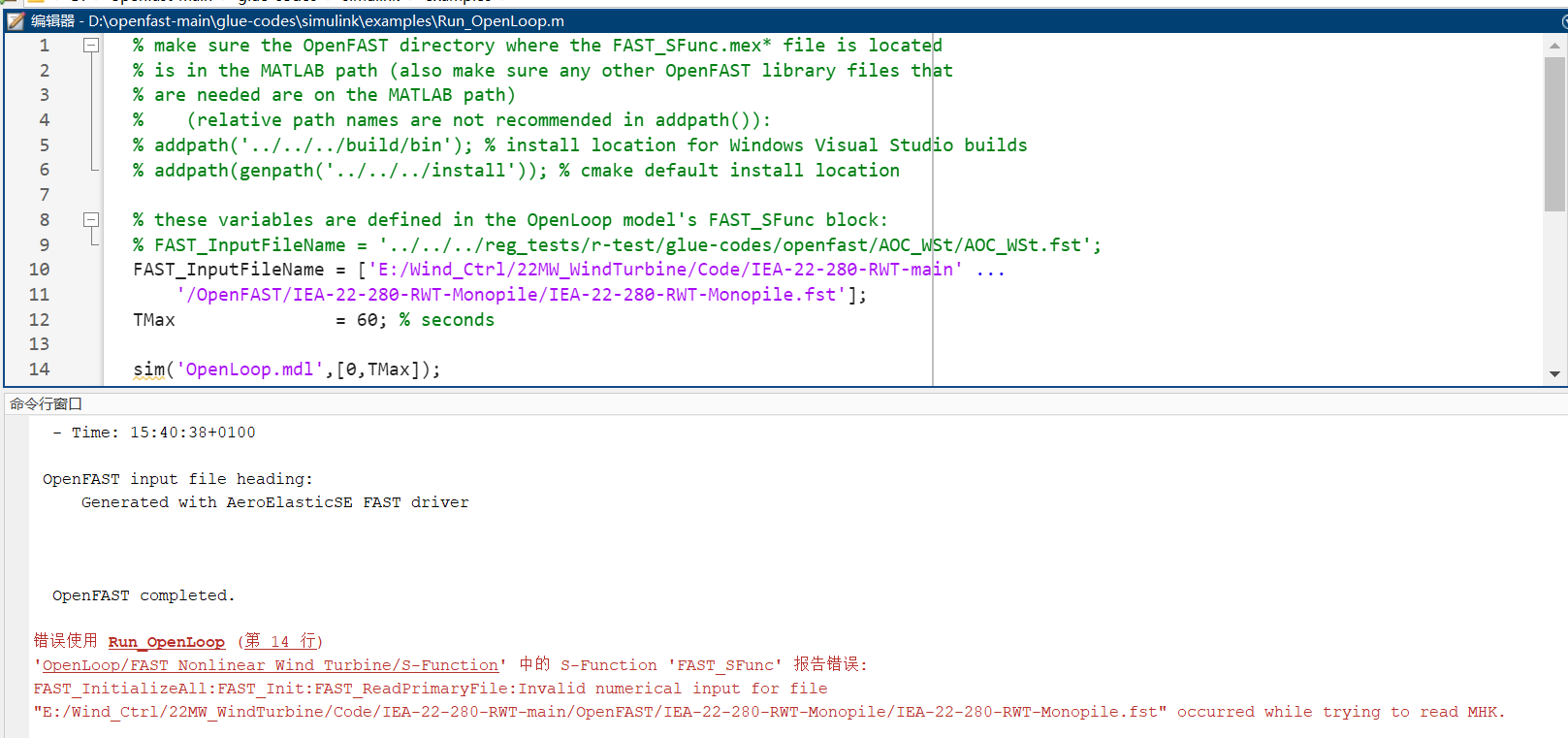

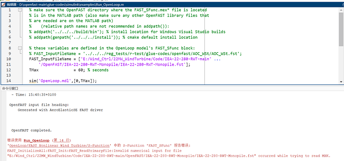

Hi Daniel,
Many thanks for your guidance. I would like to use matlab S-Function to call the 22MW wind turbine for testing control target.
As you mentioned eariler, I use the simple Simulink examples to try, it runs completely. Then yet, when I changed the path to a 22mw .fst path, its gives me the error of invalid numerical input.
Could you please help to look at?
Yong
Dear @Yongxiang.Lei,
My guess is that your OpenFAST input file(s) for the IEA Wind 22-MW RWT are not compatible with the version of OpenFAST within Simulink (i.e., the OpenFAST S-Function) you are running. Input file changes with each release of OpenFAST are documented here: 4.1.2. API changes between versions — OpenFAST v4.1.1 documentation. And you can always enable the Echo option in OpenFAST input files to debug issues associated with input file processing.
