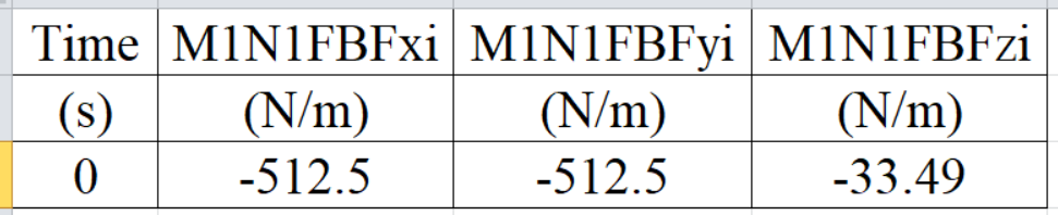

I am currently reading the HydroDyn output module in OpenFAST (version 3.5.3). The turbine is a fixed-bottom offshore wind turbine using Test #21: NREL 5.0 MW Baseline Offshore Turbine with OC4 Jacket, with a water depth of 50 m. The wave condition is regular with the following parameters: WaveMod = 1, WaveHs = 8 m, and WaveTp = 10 s. In this process, I output M1N1FBFxi, M1N1FBFyi, and M1N1FBFzi at t=0. Here, M1N1 refers to JointID 5 of Member 17, whose global coordinates are (x,y,z)=(5.333,5.333,−24.614) m, as shown in the figure below. However, I have several questions regarding these outputs, as follows:
  1. Are M1N1FBFxi, M1N1FBFyi, and M1N1FBFzi reported in the global coordinate system?
  2. If the outputs in Question 1 are reported in the global coordinate system, then according to Section 7.5.1.1.5 “Ballasting” of the HydroDyn User’s Guide and Theory Manual, M1N1FBFzi should be zero, because Member 17 is not tapered, i.e., ∂R/∂z = 0. However, the output shows M1N1FBFzi ≠ 0. Why is this the case?
Dear @Yangyang.Li,
Regarding (1), yes, these loads are expressed in the global coordinate system.
Regarding (2), the Hydrodyn User’s Guide and Theory Manual you are referring to is outdated. More recent documentation is available on OpenFAST ReadTheDocs: 4.10. HydroDyn User Guide and Theory Manual — OpenFAST v4.1.2 documentation.
