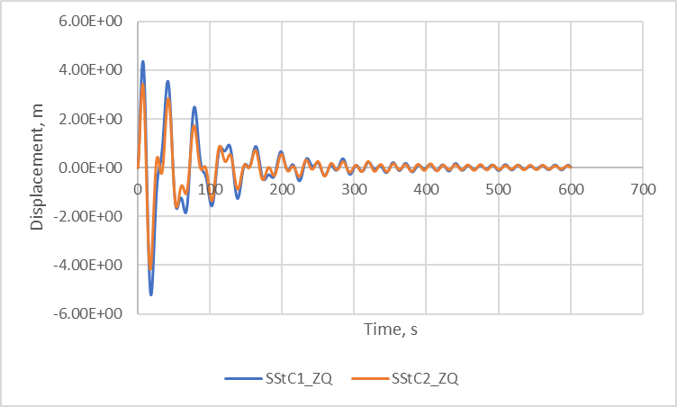

Thank you for responding so quickly. It looks like the maximum vertical displacement of the TMDs is approximately 4 meters. I plotted two of them here:
To answer your second question, the preload is set to “gravity”

Dear @Ryan.Okuda,
It looks like the mean displacement of the vertical TMDs is zero as expected. Where have you placed the at rest position of the TMDs?
