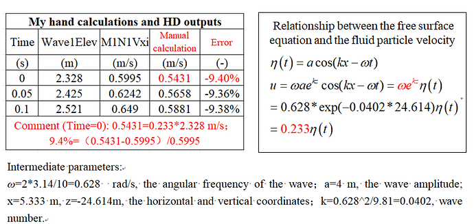

Dear @Jason.Jonkman,
I am conducting analysis of the 5MW OC3 offshore wind turbine (OWT) using OpenFAST ,Through my review of literature on linear wave theory, I understand that the kinematic properties of regular waves (e.g., velocities and accelerations) can be theoretically described by Airy wave solutions. For example, the horizontal and vertical velocities are typically expressed as:
In my OpenFAST simulations, I attempted to validate these theoretical predictions. While the results near the free surface show good agreement, I noticed subtle differences at greater depth . Could you kindly advise on potential factors that might explain this behavior?

I am currently studying the HydroDyn module in OpenFAST (version 3.5.3). The turbine is a fixed-bottom offshore wind turbine, using Test #21: NREL 5.0 MW Baseline Offshore Turbine with OC4 Jacket, with a water depth of 50 meters. The wave condition is regular, with the following parameters: WaveMod = 1, WaveHs = 8 m, and WaveTp = 10 s. I have encountered the following questions:
  1. I output the wave elevation at node 5 of member 17 using NWaveElev = 1 and set WaveElevxi = WaveElevyi = 5.333. For the horizontal wave velocity in the x-direction, I used NMOutputs = 1, MemberID = 17, NOutLoc = 1, and NodeLocs = 0. I manually calculated the wave velocity at node 5 for the first three time steps and found about a 9% discrepancy compared to the output values. The specific calculations are shown in the table below. Member 17 extends from JointID 5 (5.333, 5.333, -24.614) to JointID 21 (4.82, 4.82, -8.922).
  2. In the .sum file of the HydroDyn module, the total buoyancy is equal to the buoyancy generated by the submerged volume minus the weight (including marine growth and ballast water). However, my manually calculated total buoyancy loads differ somewhat from the output values, as shown below. Additionally, how should the external and internal buoyancy be interpreted in this context?
  3. (1) This feature—Hydrostatic Restoring for Strip-Theory Members of Floating Systems (Section 6.8.3 of the HydroDyn User’s Guide and Theory Manual)—is only active when PotMod = true, and the members are composed of user-defined nodes with PropPot = false; however, if these members have PropPot = true, the feature is still not effective. (2) If PotMod = 0 (i.e., using only Morison’s equation), this feature is not available.
Dear @Yangyang.Li,
Here are my responses:
  1. Your hand calculation is using the formulation (involving EXP( k * z ) for infinite depth whereas HydroDyn is using the formulation for finite depth (involving hyperbolic COSH() and SINH()).
  2. HydroDyn does not compute the buoyancy of strip-theory members based on displaced volume. Rather, HydroDyn computes buoyancy based on integration of hydrostatic pressure over the wetted surface. This is particularly important for pile-based fixed-bottom substructures such as monopiles and jackets whereby there is no hydrostatic pressure on the bottom of the pile embedded into the seabed.
  3. This section of the original HydroDyn User’s Guide and Theory Manual is outdated, and does not apply to newer versions of HydroDyn (including from OpenFAST v3.5.3 and newer) where the buoyancy of strip-theory (Morison) members is now recalculated every time step based on the displacement/deflection of the substructure.
