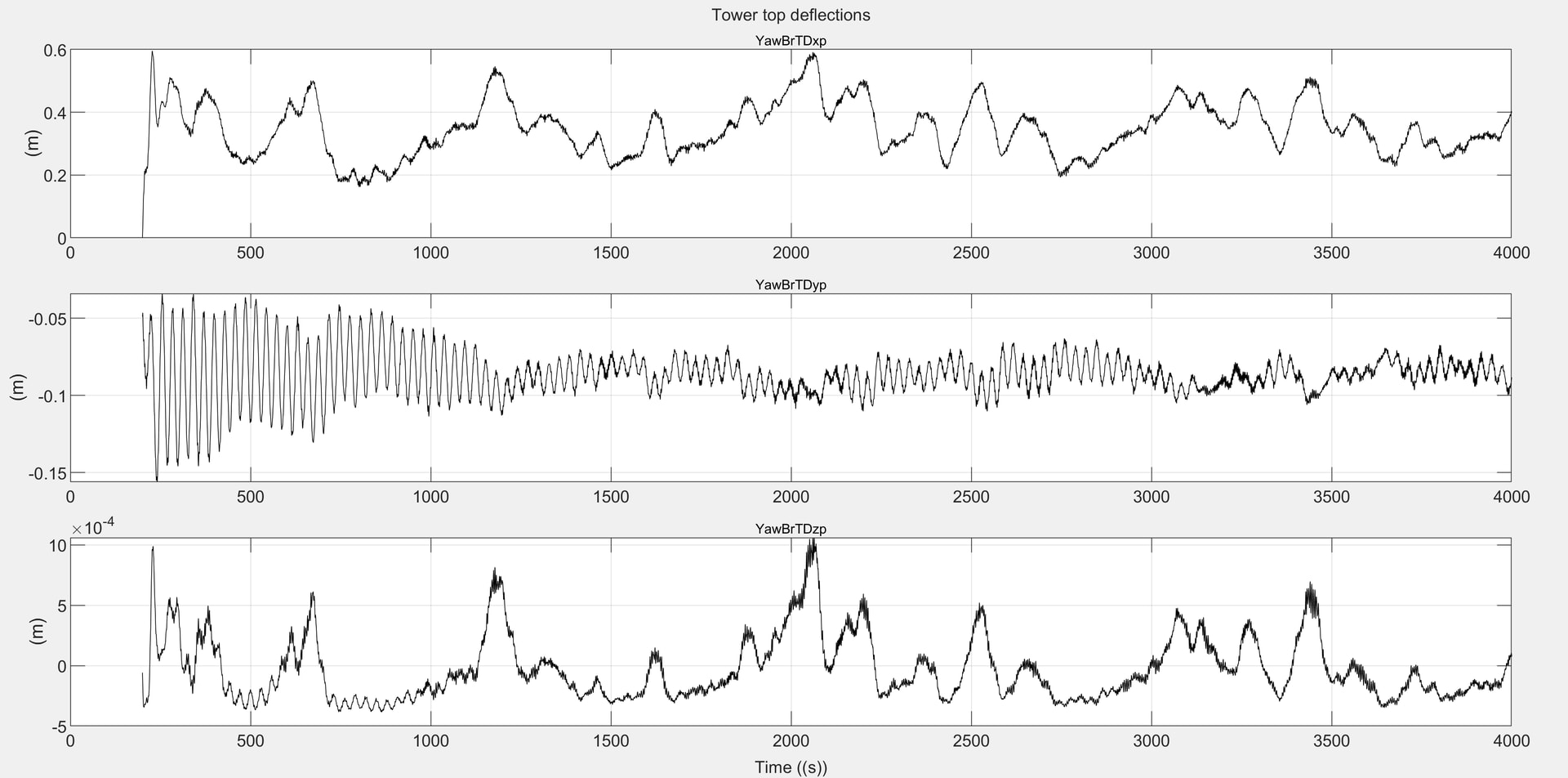

I am investigating the response of IEA22MW floating wind turbine to different coherence models. Here, the field is generated using Davenport’s empirical model. One of the outputs I am interested in is the Nacelle responses, forces and moments. However, since the nacelle itself does not have displacement response nor channels of forces and moments, i chose to use the tower top outputs as suggested in Nacelle Motions
When i plotted the forces of tower top / yaw bearing (YawBrFyn), i saw that during 4000 seconds in the simulation, the forces in the yn are almost always negative.

Thus from the results, since YawBrFxn is always positive, the turbine is always pushed backward toward downwind direction (which is reasonable). But looking at the output of YawBrFyn, it seems like the turbine is always pushed to its left, thus in the -yn direction (which puzzles me.). The turbine rotor plane is perpendicular to inflow wind (undeflected yaw). And although we have coherence, the spatial correlation between points is equal in both direction (horizontally), thus I would expect to see the turbine oscillating between negative and positive yn. The displacement also confirms that the tower top is pushed to -yn direction all the time. My question is as follows: isn’t it odd to have such a result for such a long simulation ? why would the forces be only negatively directed all the time ?
Dear @Zuhir.Jamaleh,
The positive xn displacement of the tower top is mostly due to rotor thrust, as you state. However, the negative yn displacement of the tower top is not mostly due to side-side forces; rather, it is due to the rotor torque, which is about positive xn. With the negative yn displacement of the tower top, the tower-top is sloped over a bit, with the positive yn axis directly slightly upward, opposite gravity, which results in a negative mean yn force due to the small contribution of RNA weight in this direction.
